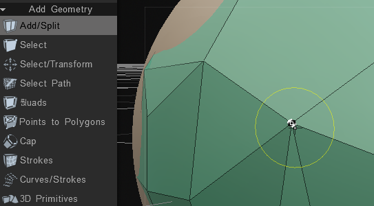

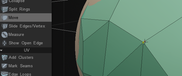

SERGYI Posted August 14, 2012 Share Posted August 14, 2012 I can't merge vertices in the Retopo room. I'm just suppose to move the vertex onto another one. Hello, Pixo! Move the vertex closer to the other one (please see the attached screenshots). To be merged the vertices should be closer. This is the same behaviour like in Windows version of 3D-Coat. Quote Link to comment Share on other sites More sharing options...

Carlosan Posted April 18 Share Posted April 18 Testing Move on 2025.01, is working as expected Try selecting Add/Split tool and move vertex to merge position. Press and hold with RMB. Quote Link to comment Share on other sites More sharing options...

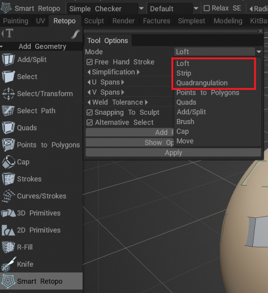

New Member cedricwurm Posted April 18 New Member Share Posted April 18 Thanks for the tip Carlosan. You're right, both the Move and Add/Split tools are welding the vertices as intended. The problematic one seems to be the Move tool within the Smart Retopo tool. Attaching a video to show this: 2025-04-18 16-45-58.mkv Quote Link to comment Share on other sites More sharing options...
Solution Dmitriy Nos Posted April 18 Solution Share Posted April 18 2 hours ago, cedricwurm said: The problematic one seems to be the Move tool within the Smart Retopo tool You need to switch to another mode in the tool. This is what the programmer intended. Quote Link to comment Share on other sites More sharing options...
