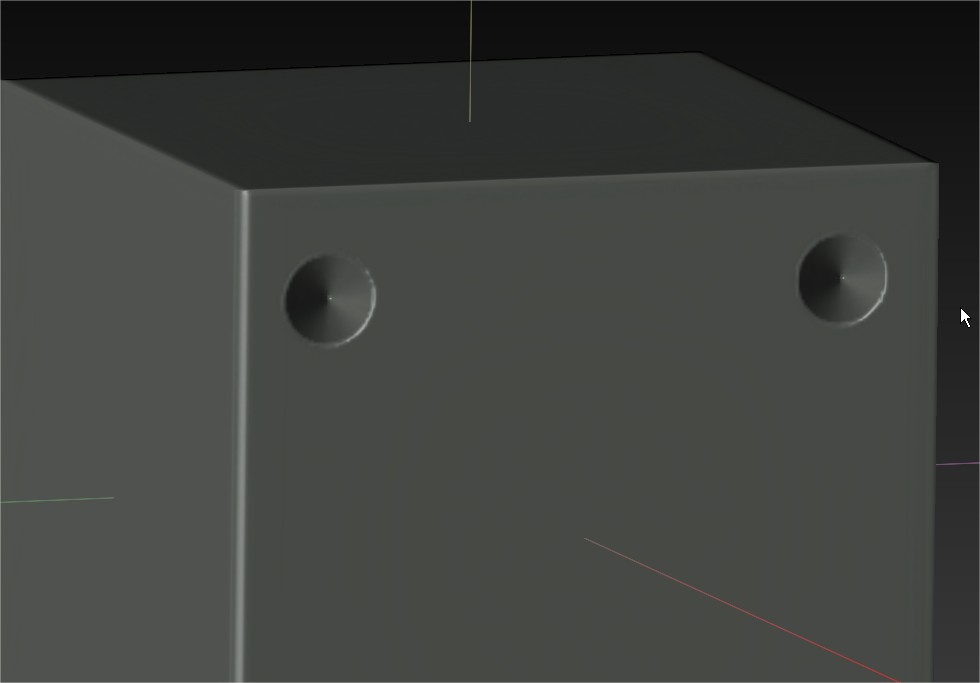

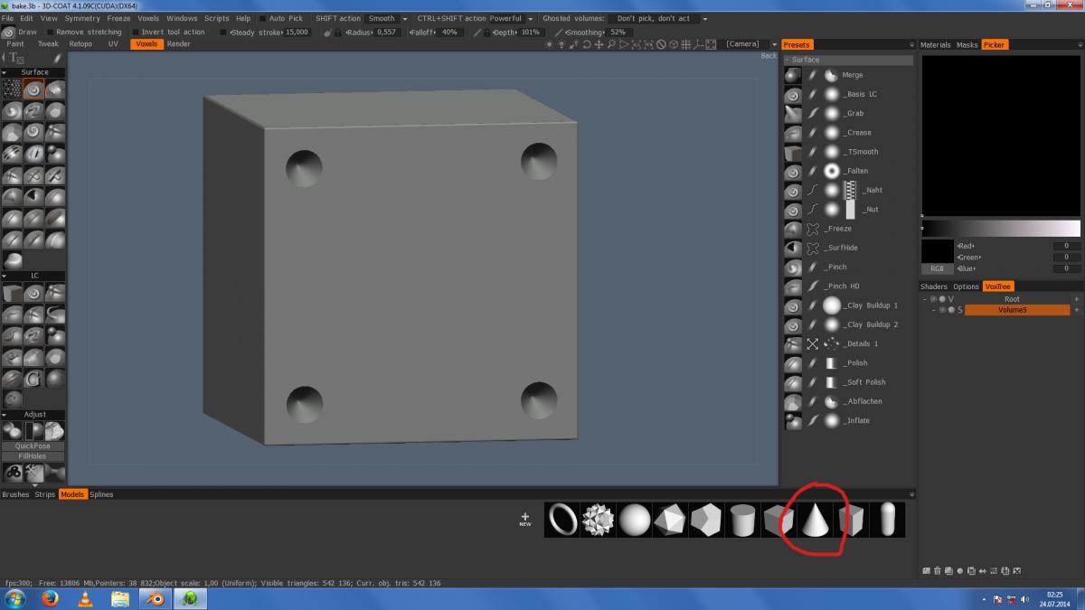

Contributor Malo Posted August 1, 2014 Author Contributor Share Posted August 1, 2014 Ok, i am still upset with that ugly baking. I always run into the same problem if i did some Lowpoly stuff. Now i found the problem. Let explain what i did I have startet with a simple cube and cut in four cones Then i create a simple 6 sided retopo. And i bake it. I choose a small inner cage to get a better contrast. You see on the read lines that the outer ring and inner ring is not symmetrical. Now i did the same with a subdivision and a smothing group. And i bake it again You see that the inner and outer circle are now symmetrical. That means for me, and this is the problem i always run into it, as lowpoly you work as ugly and incorrectly the baking is. This is ridicules for game assets. Sure you could say, then use always subdivision and smoothing groups, but i have to say that wont works. If i have a more complex shape like this. You get much uglier and weird result. Like this. You see the smoothgroups split the edges and the subdivision creates a circle out of the rectangle. Take a look into the wireframe and you see what i mean. What we need is an option for simple subdivide and not only a catmull subdivide. Did anybody know a solution for that? It sucks if i have always to switch to an external app to subdivide there and reimport it back to 3d coat for a good baking qualitiy. Quote Link to comment https://3dcoat.com/forum/index.php?/topic/16318-ugly-baking-and-wrong-export/#findComment-111519 Share on other sites More sharing options...
Contributor ajz3d Posted August 1, 2014 Contributor Share Posted August 1, 2014 (edited) Could you upload those two 3b files so we can test them? I tried to reproduce the problem, but it bakes OK on my end. Edited August 1, 2014 by ajz3d Quote Link to comment https://3dcoat.com/forum/index.php?/topic/16318-ugly-baking-and-wrong-export/#findComment-111527 Share on other sites More sharing options...
Contributor ajz3d Posted August 1, 2014 Contributor Share Posted August 1, 2014 (...)What we need is an option for simple subdivide and not only a catmull subdivide. Did anybody know a solution for that? It sucks if i have always to switch to an external app to subdivide there and reimport it back to 3d coat for a good baking qualitiy. If you turn off Auto Snap, then you can subdivide retopo mesh as much as you like without making it snap to a surface of a reference mesh. This is the same as simple subdivision. Quote Link to comment https://3dcoat.com/forum/index.php?/topic/16318-ugly-baking-and-wrong-export/#findComment-111529 Share on other sites More sharing options...
Carlosan Posted August 1, 2014 Share Posted August 1, 2014 Quote Link to comment https://3dcoat.com/forum/index.php?/topic/16318-ugly-baking-and-wrong-export/#findComment-111531 Share on other sites More sharing options...
Contributor Malo Posted August 1, 2014 Author Contributor Share Posted August 1, 2014 (edited) @ajz3d Sure, if i subdivide my model i have more polys, but then i am not able to export a lowpoly model. And in your first picture i see the problem again. If the baking would be correct, the grandient color of your hole would be symmetrical. On yours it is on all 4 sides different. File is in the attachments. The second is lost, i have delete it. @carlosan Sure you subdivide it, but at the end i dont have a 6 sided cube. Like the same as ajz3d explain with subdiviide. I need the lowpoly, not a mid or highpoly. but i cant bake with the lowpoly, that gives ugly results. I cant use the subdivide option, because is makes everything to a rounded object, thats good for organic stuff but not for hardsurface. bake.7z Edited August 1, 2014 by Malo Quote Link to comment https://3dcoat.com/forum/index.php?/topic/16318-ugly-baking-and-wrong-export/#findComment-111537 Share on other sites More sharing options...
