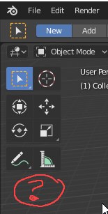

Thanks but in the first part of the video it shows the 3dCoat menu appearing top left under the tool. When I enable the applink I dont see anything.. see image..
EDIT: OH wait. I just read your email properly. Press N and the link is there. I see it. Thanks! :)

Pressing n key will open panel on right side of 3d view. Applink menu is moved there.
