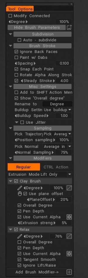

This new brush engine lets you modify controls for the sculpting tools. There are a wide variety of brushes and each one has a unique property.
To access Tool options you need to click Edit brush parameters.
This picture shows the new Brush Tool Options Panel

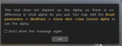

This option is not supported if Modify connected is enabled. Uncheck “Modify connected”

Switch on Use current alpha to access to the library of alphas (T hotkey).
Switch off to use new procedural alphas.
