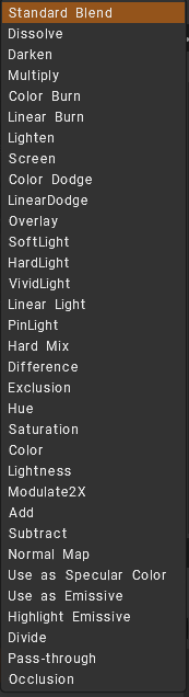

Blending modes
Layer Blending in the 3DCoat Paint Room controls how the pixels, colors, and depth details of one layer interact and combine with the layers beneath it, functioning similarly to layer blend modes in software like Photoshop.
How It Works
  • Blend Modes: You can set individual modes (like Normal, Multiply, Overlay, or Color Dodge) to dictate how colors and brightness mix across stacked layers.
  • The Blending Panel: Hovering your brush over a layer reveals a downward-facing arrow; clicking it opens the advanced Layer Blend panel (also found via Window > Popups > Layer Blending).
  • Channel Control: It manages not just standard color diffuse information, but also how depth, glossiness, and normal map details blend independently across your 3D model.
  • Lock Texture: The blending panel lets you lock color or depth textures over a layer regardless of resolution changes, saving performance while you texture.
  • Pass-through: The blend mode is applicable only to groups. It makes the group act as if there is no group in terms of color mixing.
  • Emissive Map: Change blending mode to use any map as emissive (Glow map.)

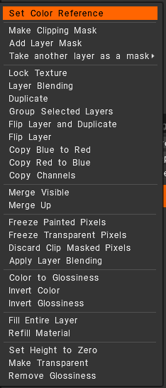

Layers RMB Menu
Right-clicking on a Layer name opens a menu of additional commands.
Lock Texture: Locking texture allows locking color/depth texture over the layer regardless of its resolution. Texture in its current state will be saved to disk. As soon as you change the resolution of the texture, the locked texture will be used instead of the current layer pixels resampling. It is very important if you want to attach materials to layers and paint in low resolution. In this case, occlusion, cavity, and the normal map should be kept in the original resolution. This function helps to keep important layers in the original resolution.
Layer Blending: Show properties of the current layer.
Duplicate: Duplicate Selected layer
Flip Layer and Duplicate: Duplicate the Layer and flip it using topological symmetry.
Flip Layer: Flip the Layer using topological symmetry.
Copy Blue to Red: This option copies the blue parts of the mesh to the red areas. Define the blue and red areas with the ‘Topological symmetry’ tool first.
Copy Red to Blue: This option copies the red parts of the mesh to the blue areas. Define the red and blue areas with the ‘Topological symmetry’ tool first.
Copy Channels: Copy any channel of one layer to any other channel of this or another layer.
Merge Visible: Merges all visible Layers together. This action is undoable.
Merge Down: Merge the current layer with the layer below. “Undo” is not available.
Merge Up: Merge this Layer and the upper Layer. “Undo” is not available.
Freeze Painted Pixels: Freeze only the painted areas on the current layer. Good for making quick masks of areas you don’t want to paint that have already been painted or invert after performing this function to mask only unpainted areas. The freeze value will be set equal to the Layer’s transparency.
Freeze Transparent Pixels: Freeze the transparent part of the Layer. It is important if you want to use the transparency mask of the current Layer on another Layer. Use CTRL +LMB on the Layer to perform the same action.
Discard Clip Masked Pixels: Discard any pixels that are hidden on the current layer, being masked by the clip mask layer.
Apply Blending: Apply blending and all effects to the current layer.
Color to Specular: Transforms color brightness to the specular channel.
Color to Glossiness: Transform color brightness to the Glossiness channel.
Invert Color: Inverts the colors on the selected layer.
Invert Glossiness: Inverts the Glossiness on the selected layer.
Fill entire layer: Fill the entire layer using the current material and color.
Refill Material: Re-fill non-transparent areas of this layer with current material. It is convenient to change the material used to fill the layer.
Set Height to Zero: Sets all heights on the current layer to 0.
Make Transparent: The Layer will become fully transparent. Removes all painting done on the selected layer and applies transparency to all pixels on that layer.
Remove Glossiness: Removes all Glossiness values on the selected layer and will be set to Zero.
