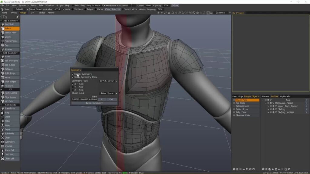

Symmetry is used for drawing, sculpting, or retopologizing objects symmetrically. Many organic and man-made objects are constructed to be symmetrical across one or more axes.
3DCoat lets you create and arrange items with this kind of symmetry.
This dialog can be invoked in any Workspace where symmetrical functions operate by pressing the “S” key or from Symmetry Menu.
By default, symmetry is not activated.
On this panel you can toggle Symmetry on and off, set the symmetry plane to be active for any of the three axes, reset the location of the Symmetry planes, hide the visual display and lock the position of the active plane position to avoid accidentally moving it with these options.
Enable Symmetry: Toggles Symmetry on/off.
Show Symmetry Plane: Toggles only the visibility of the symmetry plane.
Symmetry Type
Mirror: Paint, Sculpt or Retopologize across a plane or multiple planes.
Radial Symmetry: Paint, Sculpt or Retopologize radially with as many radial slices as needed. Can create radially and across a symmetry plane simultaneously for more complex procedures if needed. Creates radial objects before the mirrored symmetry.
Radial Mirror: Paint, Sculpt, or Retopologize across a symmetry plane. A hybrid of Mirror and Radial modes. Creates the radial objects after the mirrored symmetry plane.
Translation: It allows for the painting/creating of periodical structures in space and tiled textures. The tiles from the splash screen are good when you use only color. They cause artifacts as soon as you try to sculpt. The translation symmetry method above is perfect for sculpting to export depth. No artifacts.
You need to create box primitive with a bit larger dimensions than your bake, like 120x120x5, in surface mode, before enabling translation symmetry with 100×100 offsets. So you can sculpt across tile boundaries without artifacts.
And usage of Layers: always create new layer in Layers panel before starting, so you can use Erase SL brush, and revert back to clean box just by deleting SL layer.
X,Y, Z Toggles: Toggles the respective plane on/off for symmetry.
Global X,Y,Z: Allows you to specify what the global center is for the symmetry plane, which can be either true Global Space, Local Space (to the Objects center) or General Case Axis, which is a customizable center, very useful to rotate or roll the symmetry axis.
To mirror an object around another select specific axis or reset symmetry and pick new point of its center. Then if you are ok with it, go to geometry/ symmetry copy.
It will make a symmetrical new object within the selected existing one.
Pick from Bound Box: pick symmetry values from volume bound box location.
Store: let you to store the current symmetry state.
