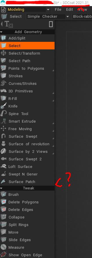

On 8/16/2021 at 9:27 AM, Carlosan said:
- New Tool "Array of copies" added to Modeling Room
143845893_bandicam2021-08-1711-55-47-870.thumb.jpg.c2d005e31a2192af21274e96004b7f41.jpg
This problem also occurred when the 'Show Open Edge' tool was added.
For users who use custom WorkSpaces in the past
When a new tool is added, there is a problem that the added tool is not visible.
The same goes for the "Array of copies" tool, which has been added to the Modeling Room this time.
It will not be visible until you reset the workspace.
After resetting, there is a hassle of having to set it up again.
This will also make it difficult for non-forum users to notice new tools when using custom workspaces.
I think it needs improvement.

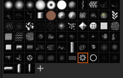

Possible lossless painting bug.
When you attach a smart material to a layer 3DC auto selects the top far left default alpha even if you have a different alpha selected.
Now you have two alphas selected in the alpha panel highlighted in orange but it will use the default alpha. (Far top left alpha in the alpha panel)
Also It seems that you must use one of the top default alphas when have a attached smart material to a layer and are reducing the resolution and increasing again.
I would choose a different alpha, decrease the resolution.
Do some painting with the different alpha. Next switch back to a top default alpha, do some more painting and then increase the resolution, the resampling was not resampled correctly on the different alpha but the default alpha was correctly resampled.
This is shown in the first picture.
Also if I painted first using the default alpha at the high resolution then switched to a different alpha did some painting, reduced the resolution and increased it again the different alpha painting was resampled incorrectly but the top default alpha was correctly resampled.
This is shown in the second picture.
Either this is a bug or we just have to use a top default alpha.
Side Note. I did not test all different alphas so if some work and some do not work I could not tell you
Last picture shows the different alpha I used. Highlighted in orange.
