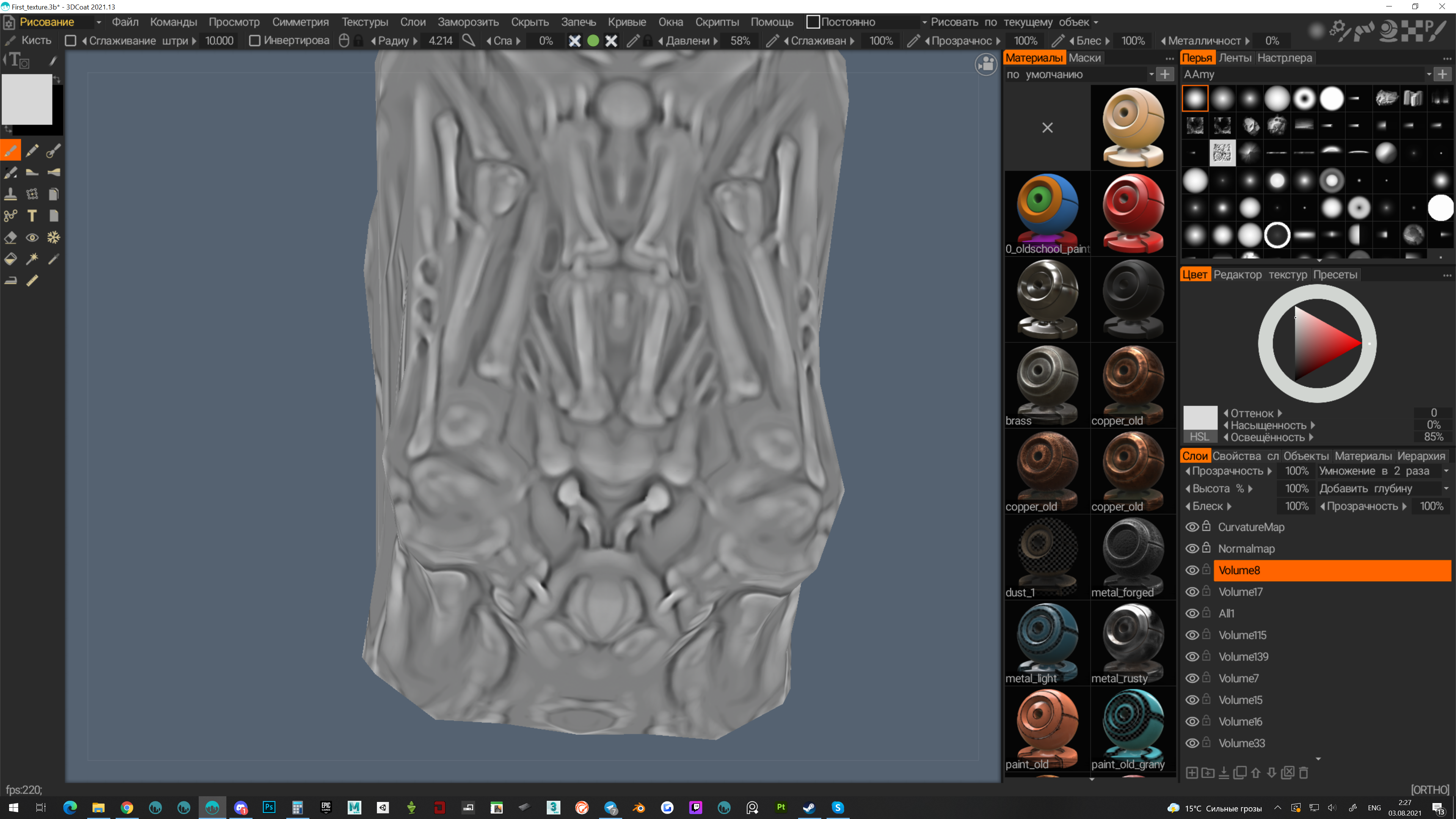

I have strange bug like as if some small ammount of steady stroke applied to cursor. See small movements dont move yellow circle.  I dont have this problem in 4.9. Also why there is some kind of cross inside circle instead of only dot? I cant see anything in options
